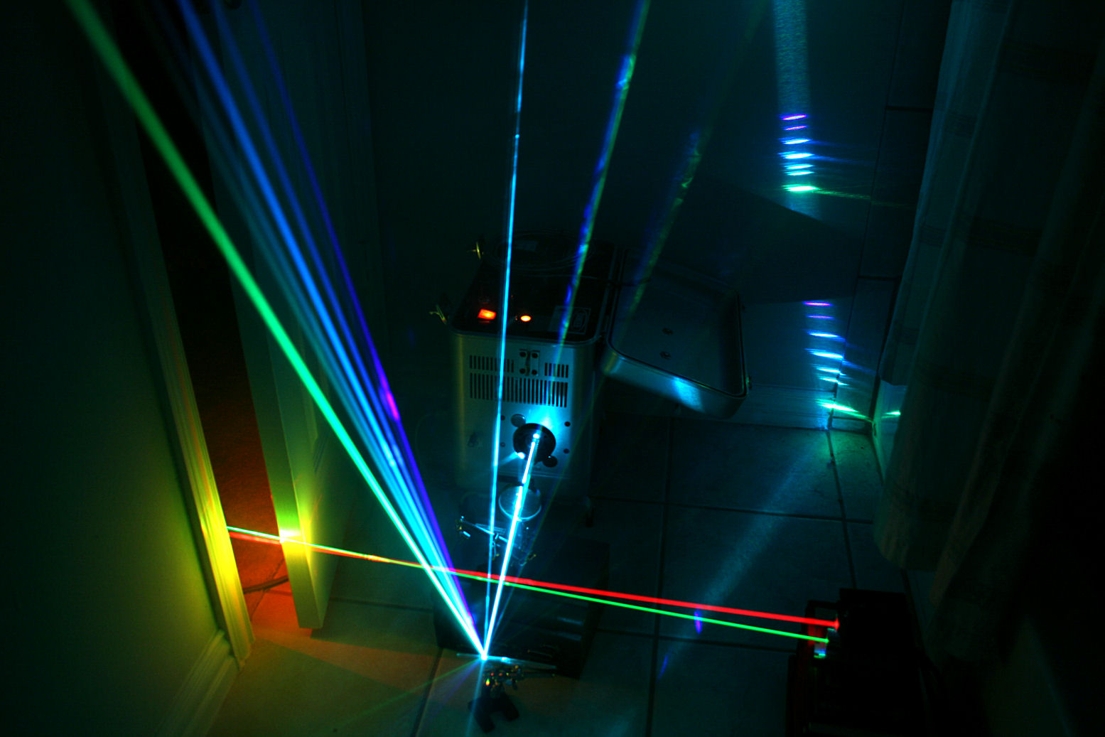

At this point, I can't resist showing off one of my old pics of my multiline argon (with a stray greenie and red laser just wishing they could steal the show):
