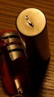

WARNING- See if you will ever buy an Ultrafire after seeing this.....
Another photo to show how much Ultrafire is a scam
BE CAREFUL TAKING APART CELLS!!!! If they are real 18650's then there is serious potential energy in them. I mean look at the post above where the ultrafire exploded and seriously hurt that old man :(
If you are going to take them apart, PLEASE BE CAREFUL, wear protective gloves, mask and gear. Do it outside in a well open ventilated area and down wind from people. Fumes may be given off if its a real 18650
I just get a laugh out of seeing all these different "inner" cells. Ultrafire is basically just like hmmmm what cell is cheapest this week? Ok we will wrap those and scam some more people
No worries. I plan to take precautions because I know from photos and video how volitle these cells can be when they fail catastrophically.
Figured you knew the dangers but didnt want new members to see your post and be like oh great idea let me go rip mine apart and then *boom* opps my finger is gone :eek:
I did have one but I sold it off because the mineral oil kept making a mess everywhere. I'm not sure it would have been powerful enough to see through my cells anyway. Maybe though! That would be a good project. I think.
Three UltraFire cells with 3 different bogus cells inside.
I also received one which only weighed about 50% of the normal 48 grams for a current #18650 cell.
I haven't opened it up yet, since I know it is bogus.
Weight your "off-brand" 18650 cells and throw away any that don't weight 47-48 grams.
