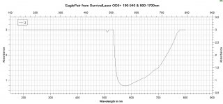

It started in January when I got a new high-power Argon, I wanted to make sure that my EaglePair 190-540, 800-1700 nm OD5+ goggles that i bought from Survivallaser could protect me from a direct hit. I own a spectrophotometer that can measure ODs up to 3, so I put my goggles in it and measured them over the whole 200-900nm range. My meter showed that the OD rating dropped below 3 around 510 nm, that should NEVER have happened since those goggles have a OD5+ rating for that region. Another server member on Styro’s Discord (puppi) posted a pic where a 505 nm laser basically went straight through those goggles while a 532 nm was blocked, confirming my suspicion that the OD of those goggles does go down quite a bit in that region.

That brought the “measure the EP OD” project to a stop, until another guy from Styro’s Discord, Spirit, measured his own pair of EaglePair 15-4 IR goggles on a calibrated spectrophotometer in a laser lab. Those have a OD7+ rating for 680-1100 nm, but he measured a transmittance (!!!) of over 1%, starting at 1050 nm and growing to roughly 5% at 1100ish. Those goggles should let less than 0.00001% of the light through, but their measured optical density is not even 0.5 for the main Nd YAG 1064 nm wavelength.
And that fact is why I’m writing this: It is extremely bad if OD5+ rated goggles dip below OD3 for some wavelengths (where you need somewhat obscure high power lasers to get into the "danger zone"), but if goggles with a OD7+ rating don’t even reach OD1 FOR THE MAIN Nd:YAG WAVELENGTH, it is catastrophic to say the least. This is not excusable. I wanted to publish my findings in a more controlled way once I got confirmation from a 3rd party lab, but I needed to address the launch of the EP 15-4 on the SL website.

@Garoq: I would highly appreciate it if you could add real data in the form of OD v wavelength charts from independent labs to the discussion to settle this simple question: Are my EaglePair laser goggles safe to use and do they meet their specifications?
Because right now, the answer to that question seems to be “probably not”.
I have attached the data from my measurements, a screenshot from Spirit’s measurement of the EP 15-4 in a laser lab, a picture of a 50ish mW 505 and 532 diodes going through EP goggles (thanks puppi for the pic) as well as my full mail conversation with Gary where I told him about my findings so you can validate my claims. The first mail to Gary (with the full data) went out on the 23.2.2021.
