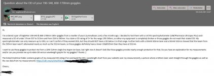

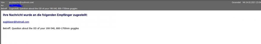

Oh, they actually replied to an email. Their claim that they "did not get the picture of the 505 and 532 laser" is false, i have send them that pic as well as my data on the 24.2.2021 (see the pics below).

I don't want to get too involved in this but, I sent an email last year to Gary with the issue. Just wanted to show that it was brought up to him and he's known for some time.
