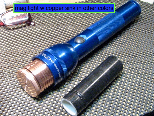

FOR SALE.. 80.00
Here is a trans blue powder coated Mag Light , for a DTR 12mm copper module. This host is prewired with 22AWG silicon wire, And the tailcap has been machined out so the spring sits low for easy battery installation. Also has a custom focus adapter, the heat sink is massive for cooling of the heat transfer of the diode. Has cooling fins grooved in the sink as well.
It also hods 2X32650 or 2x26650 batteries and includes a reducing tube for the 26650.s
Thank You Rich:)
Love this host Rich! I spent a fair amount of time this year learning the lathe to try to recreate one of these jayrob / jayzeerer builds. Really wish I would have seen this one first! :confused: Great job!!
