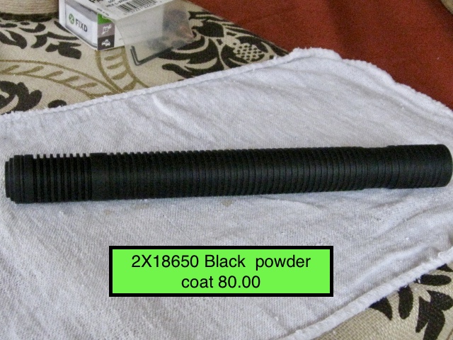

Hi, Ok I can machine a host prewired matte black powder coating. But your going to look for the 808nm diode driver set up. Maybe some one on the forum will help with that.
Here is a pic of the host .
Rich:)
Holy crap! I was going to ask at some point if you do black powder coating. That's the coolest I have seen yet! I have so many ideas now.
Hi
The host holds 2x18650’s and can also have a full copper heat sink with a black power coating body
Rich:)
