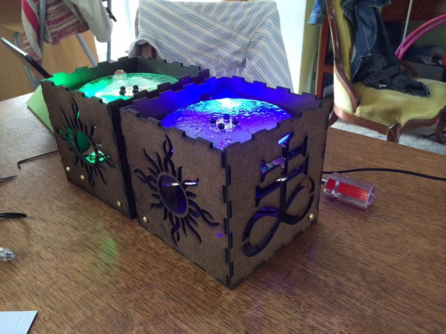

over the last couple of weeks i've been building a 60W laser cutter. it's not complete, but it's up and running and i thought a suitable first project would be using the laser cutter to make a laser projector.

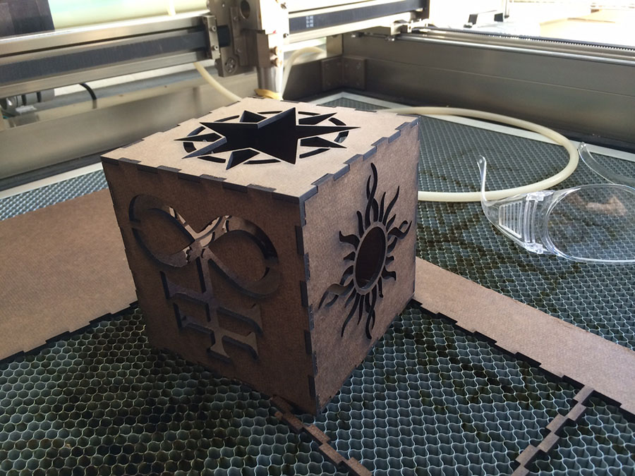

i designed a 5x5" box in inkscape and cut it out of 3.2mm masonite.

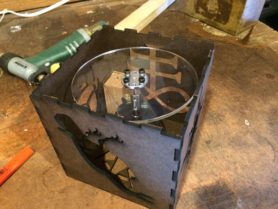

i laser cut acrylic for the mounts and the lumia wheel.
i used clear silicon sealant to add texture to the lumia wheels. the lasers are single mode 450 and 520 diodes and drivers from DTR's shop.

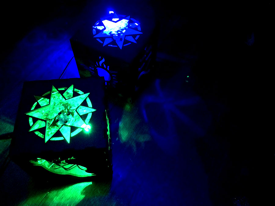

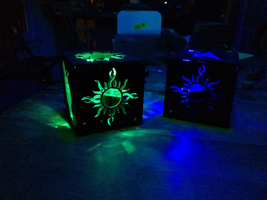

in the dark, lumia reflections off the wheel project out of the cut outs on the side panels.
the projected lumia is very beautiful.

what is your motor and its speed- tell us more about the lasers you choose too..

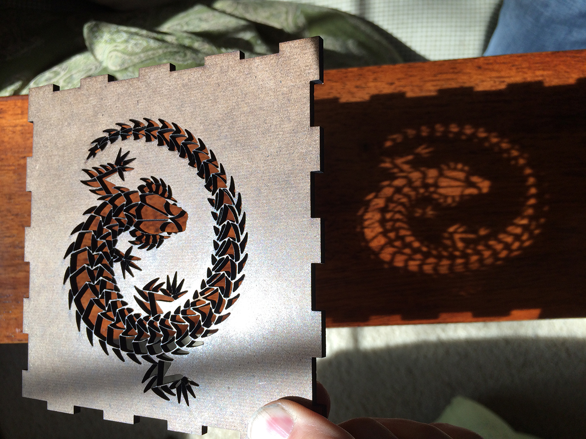

the resolution of my laser cutter is quite high so i can do much more detailed artwork on the panels.

Damn Dude, those panels are drop dead cool. I would be up for a kit or two when you are ready to offer them for sale. Love the dragon!!!! Moon and stars motif is very cool too.
