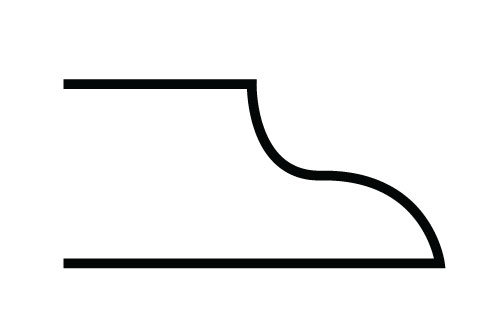

Well, I don't even understand what kind of edge profiling you are talking about, this is lamb tongue edge profile:

You can't just take a belt sander to a block of aluminum and magically shape it. You can't grind it either because aluminum clogs grinding wheels. It is possible to mill an edge profile like that though with a corner rounding endmill and a ball endmill. I don't have the right size and shape endmills to do that though, but it can be done if we need to order them. I'd recommend just round the edges off and that being it. I don't see why you need that fancy edge profile. Plus it is just going to require more material further increasing cost.

no thats an ogee curve.. i posted a couple thumbnail sketches on the first page
a lamb's tongue is made by using the draw knife at a 45 to the edge starting from one end and pulling to the other. often the woodworker stops at the center of the piece and begins again drawing from the other end making a nice continuous line. think of the tables and woodwork at a seafood restaurant. it is a crude simple edge treatment.
