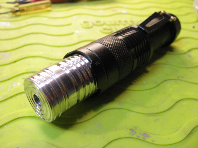

FOR SALE.. 35.00 + 5.00 1st class mail
Here is a 1X18650 / 2X18350 host prewired , bored for a DTR 12mm diode and driver.
Thank You Rich:)

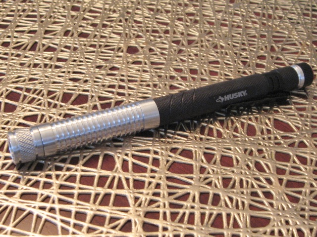

FOR SALE.. 40.00 + shipping 1st class mail 5.00
Here is a 2x10440/2XAAA pen host prewired , Holds a DTR 12mm copper module with driver. Also has a custom contact board built in the heat sink.
Thank You Rich:)
E7E3A567-426D-4AFF-9103-71F396EA44A3_1_201_a.jpeg777DE66B-760A-4266-AA02-400AC5484092_1_201_a.jpeg90109F3A-74E4-4925-AC8E-4BDA04917051_1_201_a.jpeg
Did you remove the tip of that host and press fit the replacement end on it?
yes I discarded the entire led and driver portion and bored out the rear to fit snug over the threads of the battery tube. Inside is a custom contact board wired . All is secured by a set screw , this is a great small pen for some single mode diodes. Believe it took a lot of time to machine this small heat sink and recess the contact board.

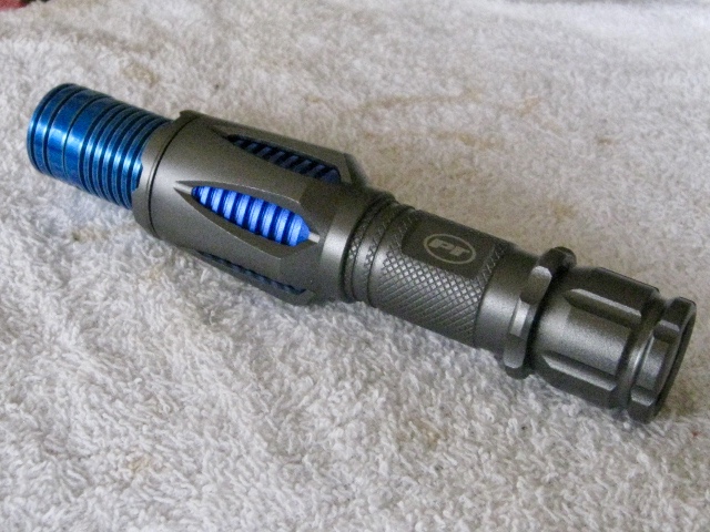

FOR SALE.. 80.00 + 9.60 Priority shipping
Here is a 1X26650/2X26350 S11 host , deep fin copper heat sink and a see thru focus adapter . It comes prewired with 22 AWG silicon wire. A great stubby host and weighs in with the copper sink and adapter.
Rich:)
