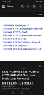

I was talking about the NUBM08 and NUBM49 because your link to a sales page is for 08's and 49's
Yes, this is the connection, but there is an option to select diodes. The last one is NUBM0E. I bought it from this merchant

Mine is exactly the same as the link you provided. You can see the difference in power in the unprotected diode. I had bought 2 pieces, but as I mentioned one was damaged. From now on I will buy only unprotected diodes. I rarely use lasers. They will probably spend years with me. I realized that I should avoid changing lenses because dust enters.

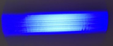

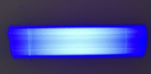

I like NUBM0E because it glows light blue. Probably over 460nm
Maybe 455nm but if you want a 462nm try an NUBM07 or NUBM0C or NDB7675 ...... you will see the difference, the 7675 can be overdriven quite a bit, see here. Also there's the Sharp 488nm which is only doing about 200mw @ 450ma overdriven, but it's single mode which means much lower divergence and the beam is fantastic at night with a G8 lens and it's a blue/green chameleon that your perception of changes based on the background, very cool laser diode.

Picture 1 NUBM0E with protection
Picture 2 NUBM0E without protection
