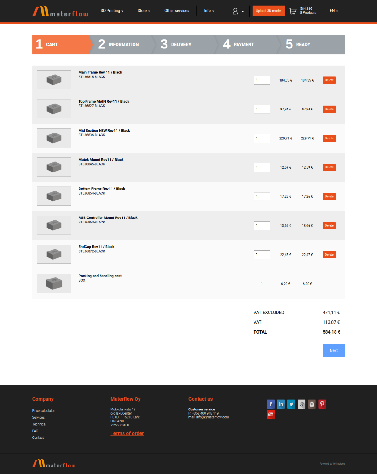

I really concider this option also.. Because there's really good 3D printing service with high quality EOS EOSINT P 395 - printer here at my home town..
They can print:
  • Aluminum AlSi12
  • Steel 1.2709
  • Stainless steel 1.4404
  • Titanium TiAl6V4
  • inconel 625
  • inconel 718
  • Stainless steel 17-4PH
  • invar(1.3912)
    And Nylon PA3200GF
BUT, price would be at least double with Nylon..
..And Aluminium... Imagine price and multiply it 10000x
Link:
Technical | Materflow Oy

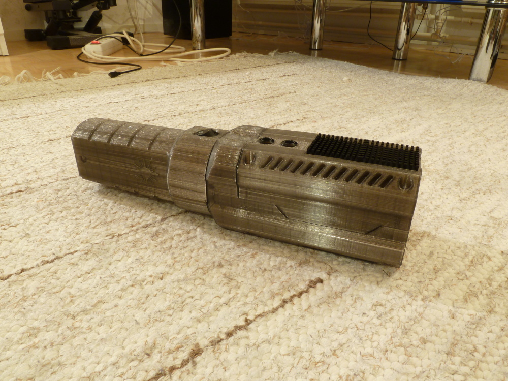

Yep, that is reason why I ended up PETG..
- Very durable, it’s more flexible than PLA or ABS
- It has very low shrinkage
- Highly impact resistant material
- Can take quite much heat before losing mechanical strenght
- It has a great chemical resistance, along with alkali, acid and water resistance
- Cheap
Good, your host should last quite nicely. :) How is printing with PETG compared to that of PLA?
Much slower and higher temperature 235C-240C while printing.. You can heat your apartment while printing stuff :crackup:

That feeling when every part fits together seamlessly.... Priceless! :p
I'm gonna hold you in tense few days more guys, that I can install all the electronics
Very good ArcticDude, can't rep you again yet. It looks great now it is coming together. Can't wait to see that beautiful RGB coming out of it. :beer:
Really looking forward to see this laser doing color cycling. PETG is always translucent even though it's "black". :p
