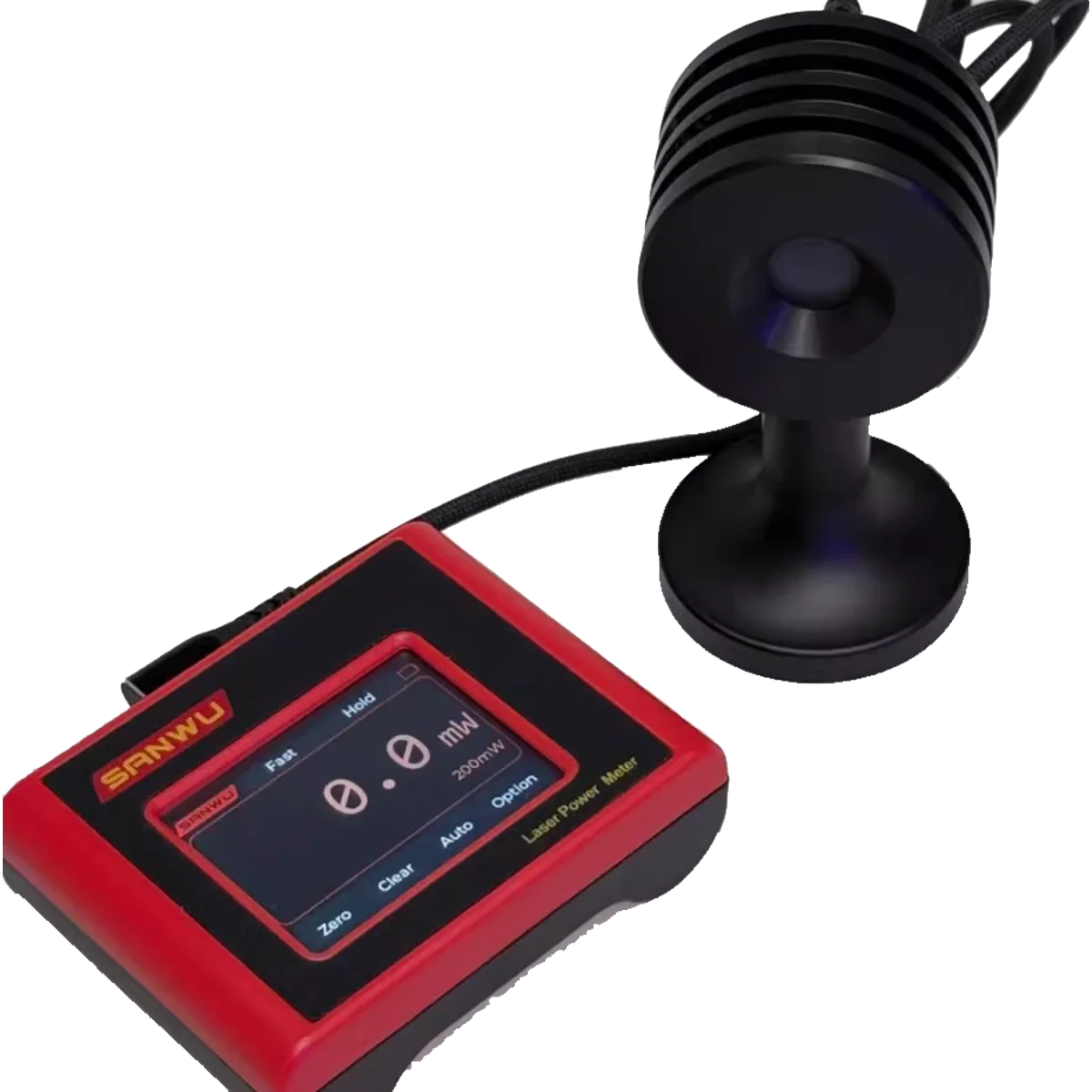

Yea those are diluted Chinese markings, the 40w one is about 7.5 to 8 max, No blue diodes exist with a power output of greater than 8wTo put this thread back on track. I am looking for a laser power meter to test up to 40 watts. I am going to start testing the cnc diode laser heads for myself. There is a lot false claims, and junk ones out there and a few legit ones. I have two that are marked 30 watts that seem to put out 5.5 watts of light and a 40 watt that puts out what seems to be about 10 to 15.

I am aware of that. I want to test them for myself and put it up on video in the laser GRBL community. Some are better than othersYea those are diluted Chinese markings, the 40w one is about 7.5 to 8 max, No blue diodes exist with a power output of greater than 8w
I thought of that myself. Or just physically blocking part of itAre all the high power meter still thermalpiles? Just wondering is there is any silicon that can take 100W or even 10W. I had some heads but I never believe the result from a thermal unit. They just seems to vary too much. The good ones seem to be really expensive but I guess you get what you way for with wavelength correction and such. Like the little hand checkers. Wonder if just using a beam slitter or ND filter would let you reliably drop the power to a range that the smaller meters can handle. Guess you'd need a know reference.
Hi Red,Before I fixed a broken hyperion I would get a LaserBee or a Sanwu LPM because the hyperion sensor area is so small, I wish I had bough a 10w capable LaserBee instead of the hyperion.

Hi,Can I ask you a question? The sensor head of my Hyperion Laser Power Meter died, is there any way to buy a replacement head?

You can attach certain Ophir heads directly to the Hyperion LPM.Can I ask you a question? The sensor head of my Hyperion Laser Power Meter died, is there any way to buy a replacement head?
Oh, I like that! How can I find out which ones will work?You can attach certain Ophir heads directly to the Hyperion LPM.
