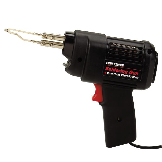

I have these: :eg: :gun:
00954046000-1
Good luck with that. ^^^ :crackup:
It's quite difficult to get solder to adhere to aluminum.
I've heard of people using a micro torch to get everything hot enough....
Even then, AL isn't meant to be soldered.
