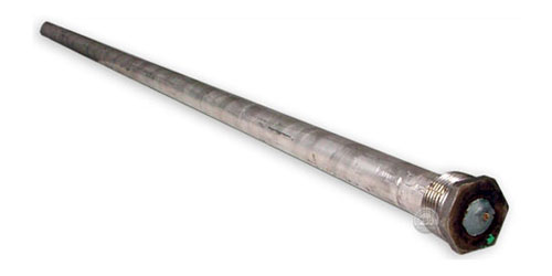

The Magnesium is the easy part to get, that's for sure. Magnesium (100%) metal (with a tiny steel core) is used as the anode in hot water heaters.
You could easily make turnings from that. Also Magnesium can be found as
