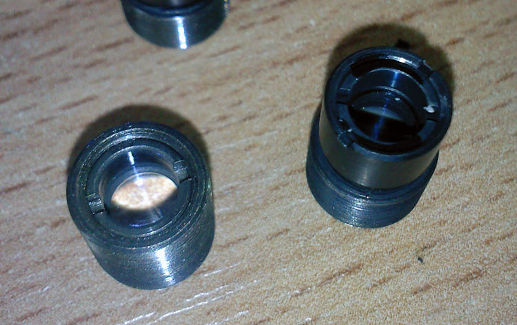

What does he mean by internal threaded lens mount?
The aixis glasslensholder and some other lensholder nuts are made with inner threaded ring wich fix the lens itself, instead of the click joint from the plastik lensnut.
I hope its visible on the picture:
daniel
daniel
Oh, ok :)
So it is possible to unscrew?
From which side?
I managed to open it, its not that hard glued.
I grind a screwdriver to fit the inner ring, and hold the lens nut with universal pliers.
Protect the nut with a bit cardboard.
But the fit with the lightpath lens is not good.
It can work because the ring press the konical lens in place, but not optimal.
And i cant screw it down to focus to a beam.
Now i think about glueing the ring with lens in place and grind the back to minimum to get some place to screw deeper in the aixis modul...
My roithner lens fit direct with the end of the lensnut and it can be crewed in to 0 focal lenght.
i guess finaly i have to lathe the complete nut :(

with A LOT of patience and some acetone, you can unscrew them, also aixiz ones, but the acetone can ruin the inside spacer ring (not the lenses that are glass, but the small plastic ring that separate the first element from the doublet)
The main problem is that, usually, they uses loctite threadblocker glue, for seal them :p
At least for my lenses ..... on all the glass ones that i had around here (like 15 or 20), i was able to unscrew only one, without ruin the screwdriver notches, and another only cutting part of the inside ring ..... all the others are still resisting to all my trials, so i left them in peace, and used them as they are :p :D
