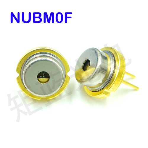

They also have the NUBM0A, NUBM0E and the NUBM0F re-canned now and the 0F looks promising, I've tested the others and they are 7W+ but the 0F could be a tick stronger.

Just to put it out here since I had multiple 0F and 0A to test also x4 0G these new efficient family vary wavelength by nm in same block is easy to find a ~3-5nm difference at same current. Appropriate cooling is very very important. The diode base makes great contact with copper heatsink that is why I designed the MHS with same slot nichia uses 2.5mm height x 5.0mm lenght just barely any space for 21Awg wires with heatshrink sleeve I use high quality thermal paste the good stuff we use for cpu overclocking. All my 0F and 0G have been tested decanned with either a G2 shorty lens or a G8 lens brand new first time use. The highest peak power was achieved on a 0F @ 5A with G2 shorty cold start 9.74W retested to check 9.46W.
Edit: Forgot to mention my 0F and 0G are virgin pins never soldered @loreadarkshade extracted 0G and I extracted 0F with lowest temperature possible...
