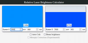

Why hasn't there been talk about this diode other than a couple one post topics posted in the wrong forums (445nm, etc)?
Considering that people are still making builds with the NUBM07 and this diode appears to supersede it, I'm surprised that this isn't available on DTR's site or even seems to be known about here.
Here's the diode I'm referring to-
Bottom reviewer is getting 5.9W at 4A drive current.
This should be the brightest blue laser diode available, 1.4X brighter with expected wavelength shift to 468nm than a NUBM44 outputting 7 watts. Even if it stays at 465nm it is still 1.23X brighter, quite a bit considering the efforts people go through with NUBM44's to get the brightest laser possible.
Also, it's $76.

look it feedback,i think seller use old product and just rename,and maybe it is a nubm08 diode
i just see some seller have it in last month,maybe it is new diode
if it have 5W+,divergence i think same NUBM44 or 08

That may be due to your monitor having a poor color gamut, watching your video there is an absolutely obvious difference between the 07 and the 44, the 07 appearing sky blue and the 44 appears almost violet in comparison when viewed on my monitor.
Can you compare the 0C and the 44s divergence? Even just a quick check with the two diodes using the same lens would be great, even without a picture. My guess is that they are the same or close to the same, that the 0C's are basically 465nm 44's.
