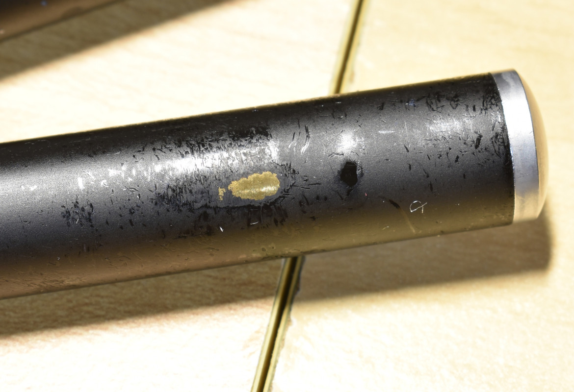

I did scratch a small patch of the coating off of one of them and it does seem to be brass underneath:
That's what confused me. Brass coating? The tips are aluminum
