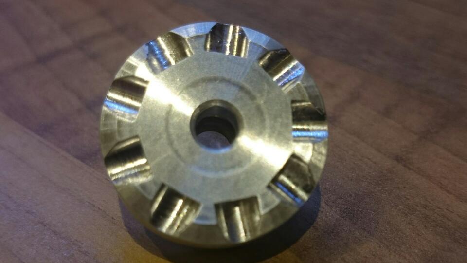

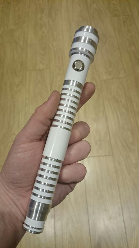

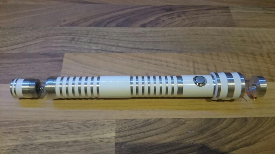

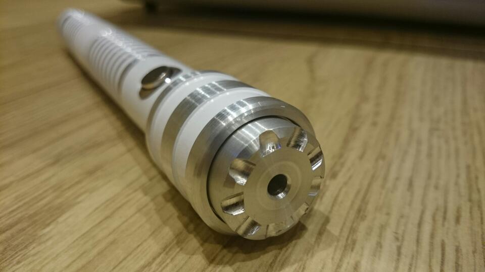

The host
This is a 2 x 18650 aluminium host with a sublime white powder coat. I worked with Ehgemus to confirm requirements and opted for a master tail switch coupled with a momentary side switch and a nicely machined focus adapter. It is a work of art.
I will let the pictures do the talking!

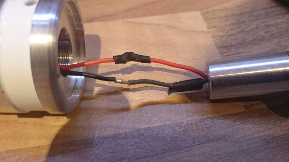

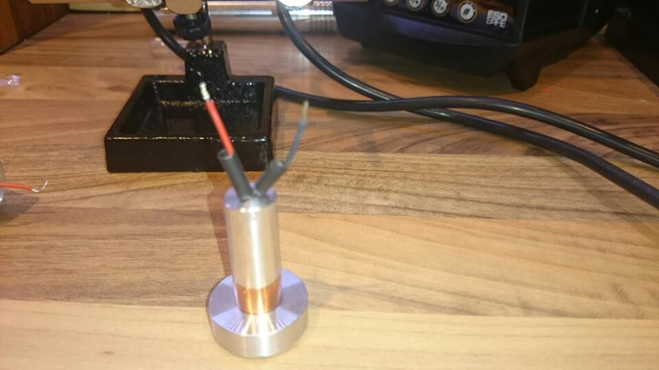

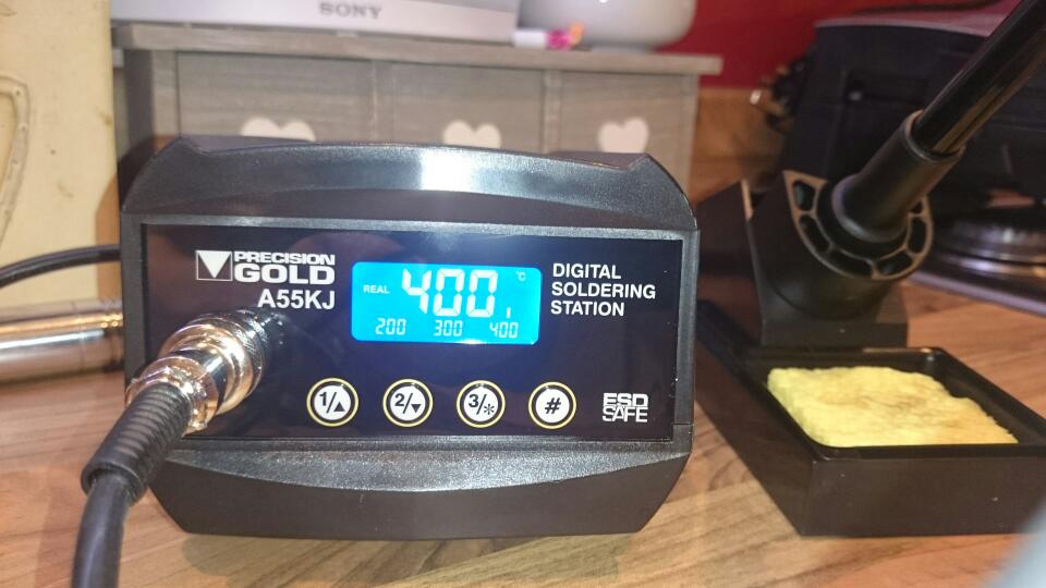

Assembly couldn't be simpler as the host came with a pre-wired contact board which was then soldered to the driver leads on the DTR module. (I tested polarity of the host before hooking the leads together).
Don't take any chances, wear an electrostatic wrist band to protect the sensitive diode from ESD.

This is my favourite laser and build thus far. The brightness and intensity of this diode are awe inspiring and the pics don't even begin to do it justice. The beam characteristics are almost identical to the blue NDB7875 diode which means that it will easily be outdone by single mode and typical DPSS units when targeting distant objects. Nonetheless this build takes pride of place in my collection; an expensive diode warrants a special host so thanks again to DTR and Ehgemus!

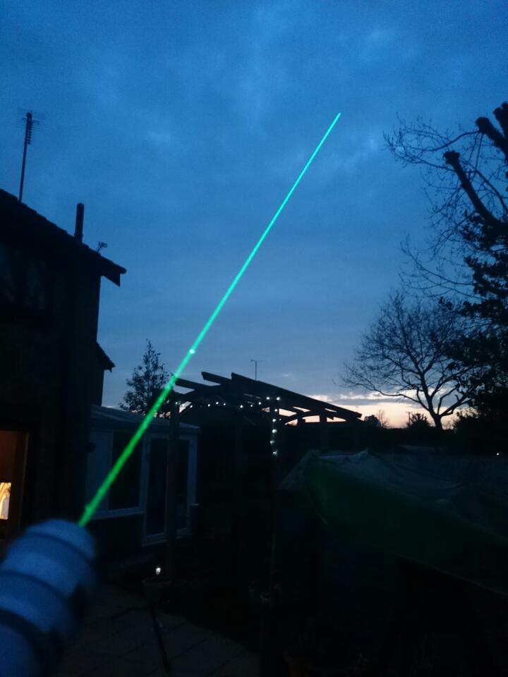

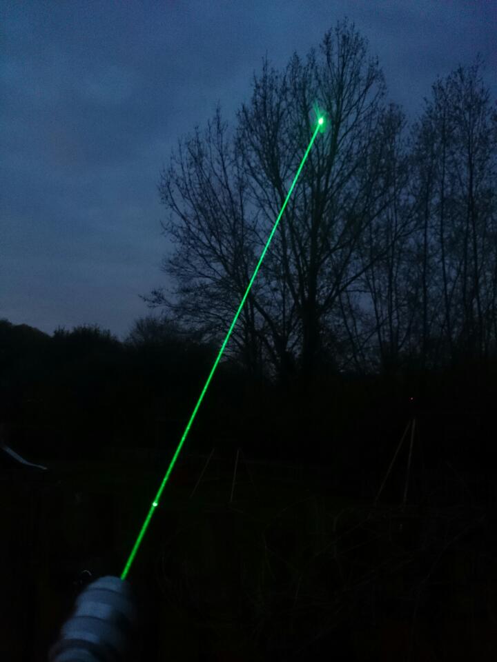

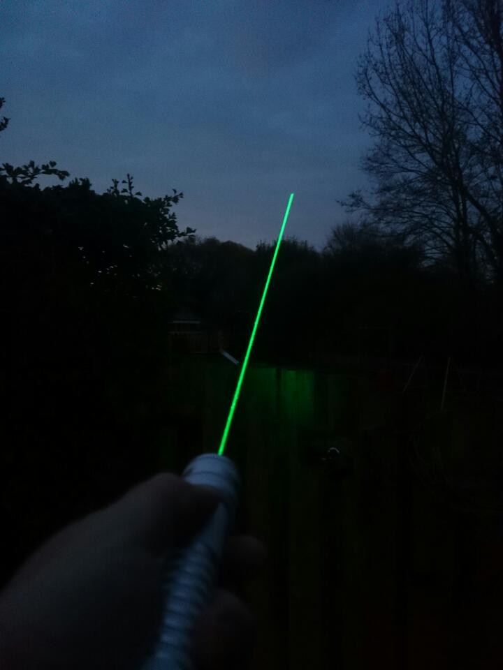

Beam Shots
Excuse the mobile phone pics!
Comparison with my 100mw and 600mw 532s.

Appreciate the kind words, advice and rep. I actually preferred a momentary switch in this instance as all my other units use a latching switch. In terms of heat transfer I am only running this for 40s at a time max which should help preserve driver and diode; the heatsink is warm to the touch after this (28C)

The beam is beautiful, divergence higher or not and for most laser enthusiasts that doesn't matter. In fact, a wider divergence adds a bit more safety for long shots unintended to land upon someone because of the beam weakening due to dispersion. But doesn't reduce the possibility of flash blindness to pilots because a wider beam is easier to hit them with, if someone were trying to do that, or on accident as happened to my poor cousin who went to jail over having done that :p

That is AWESOME!! I love the host. Well done to Ehgemus. Really good looking focus wheel/adapter too. Elegant bit of kit with a fantastic output.
I really like 520nm, very nice colour to behold. Especially with a fat beam like that one has :bowdown:

Thanks for posting the review, enjoyed it, well worth a look. Excellent work on putting it together, and very nice beamshots :thanks:
