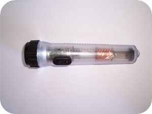

I don't think a transparent laser would look cool at all. It would look like this flashlight:

Well there you go... That looks plastic & cheap though, not what I had in mind at all. Thanks for sharing that. If there were a host that was mostly stainless steel with I don't know, maybe a window or two on it made with transparent aluminum to see inside or right through the thing...? That could look alright, maybe only in a futuristic kitchen or something though.
