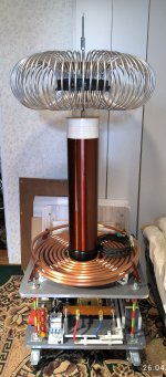

Before getting into lasers I worked a lot on some Tesla coil projects. I'd like to share some photos of one of my vacuum tube tesla coil (VTTC). It utilized a conventional Armstrong oscillator with a GU81M transmitting tube and a power supply based on the russian microwave oven transformer and a VG237 mercury vapour rectifier which worked in a level-shifter circuit to double the voltage from the transformer. The resonant frequency was about 300 kHz, the secondary winding is 25cm tall and 12 cm diameter. With the severe overload of the tube the length of the streamers could be up to 70 cm.
Now I'm planning to build a fully "vacuum" QCW VTTC, with all circuitry on vacuum tubes, but my laser hobby doesn't allow me to do this, its very hard to find time and place on my working table.

Great looking VTTC, how much current are you pulling? I had a problem for a while with tripping breakers.

I didn't really notice, but less then 20A. i didn't try to build a staccato, but probably I'll try... with a thyratron. But building QCW VTTC (like QCW DRSSTC but VTTC) I find more interesting and challenging. There are a couple of possible paths to achieve this. I tried one, but it was incorrect.

Hi, my tesla assembly has a 0.5mm copper wire secondary winding. Which is the best copper pipe to use for the primary winding, 8mm or 9.52 mm?
Above, I showed the circuit I used, but added a laser tachometer, transformer operation indicators, cooling, primary winding selection, and voltage selection after the transformers from 2 to 6 kV.
However, the circuit works poorly even with three transformers. If you remove an object that could be struck by lightning from the toroid, the sparking continues only in thin, barely visible discharges.
Perhaps the losses are due to the added components, such as the primary coil winding selection, which involves many soldered and bolted connections.
I spent almost two years making the circuit. I really don't want to change everything, but I understand I'll have to. I wrote the text through a translator.
Can anyone tell me what the problem is?
