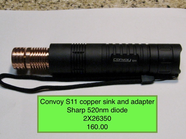

Hey Rich, I just received the 2 x Sharp GH04C05B9G 440nm 5W that I paid 35.00 each for from Chinese ebay seller " sabhz21 " only they were 600mw 520nm diodes which have the same big window apparently, have you received any of these Sharp 5W blues yet ?
This is what the 600mw 520 I received looks like.

I have those 600mW 520's bought them a while back and did I few builds for customers. They can be pushed to 900mW's easy, but with all my diodes I put them on a PSU first to see how efficient one from another are. Some can take it and some can't.

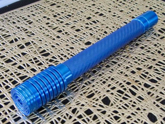

Hi Red,
its yellow Brass with w high polish. It finishes up really nice. I figured it would contrast on the Trans Blue powder coating

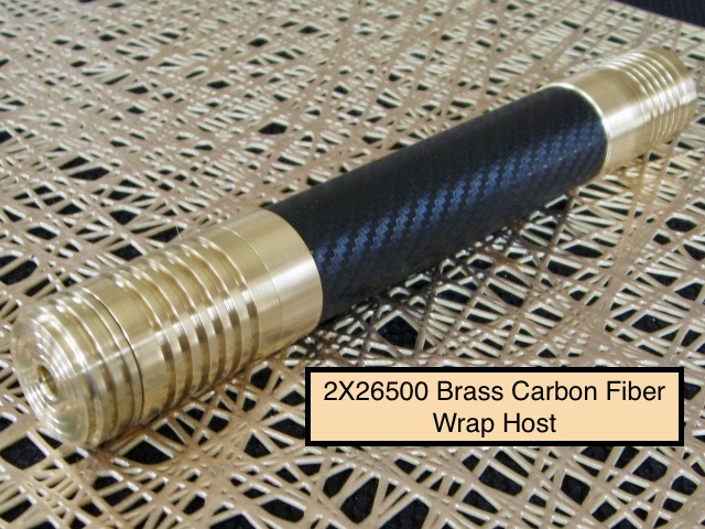

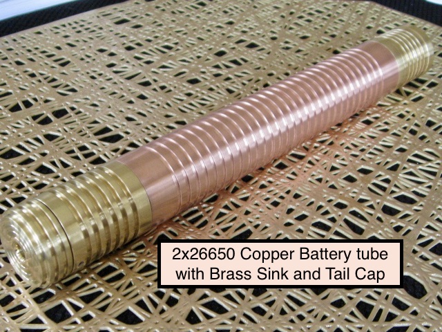

The other 26650 Carbon Wrapped Big Boys are nice!
Hi GSS,
Yes that was nice build with the extra cooling for the diode and driver the customer also took 2X18650 Panasonics and a charger.
Those 2x26650 and 26500 builds had a brass sink bored out for a DTR 25mm heat sink. They came out nice with the polished brass sink and tail cap. Also had a 19mm latching switch installed ..

That looks gorgeous Rich!
I was just saying it would be funny/interesting to put a green diode in that blue host for a cool contrast of colors.
