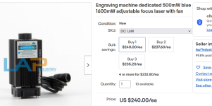

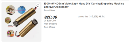

These engraving lasers differ greatly in price. Do they differ greatly in performance ?

If all claims are exact (which on ebay from chinese sellers is a gamble), theh 405nm 1500mW will greatly outperform the blue laser.
That being said, thhe blue laser module has a driver, fan, heatsink included all in oone. The single 405nm diode does not, and you will need to purchase those seperately.
If it were me, I would DIY all of the parts, because theres NO WAY it's worth $240 USD for a 2W blue engraving kit.
PM me if you want me to build you one for half the cost.

Those 1500mW Violet on Ebay are not 1500. I bought one a couple of years ago. From memory they are about 200mW.

My guess is the first one is 405nm (violet) at 100-200mW and the second one is a 445nm (blue) at 1.2W.
However I have bought several eBay “405’s” that turned out to be 445nm’s, it’s always a gamble unless you buy the diode/module directly from a reputable seller

Thanks. Could it be that chinese interest$ hide which published milliwatts are electrical consumption and which are optical emission power ? Telling the truth could impair sale$, right ?
The one with heat sink/fan has the exact same12mm module inside. There is no room for a driver board unless inside the 12mm module. Is it there ? Do the 12mm modules have a driver circuitry built-in or need the external driver board ?
