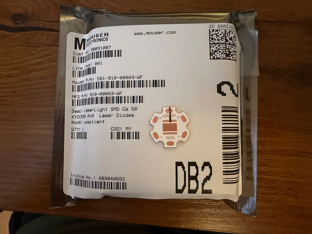

- built for multiple projects
- all of them with multiple laser chips in series
