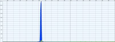

Not much variation on WL between diodes with one peak at 454nm (500ma)
