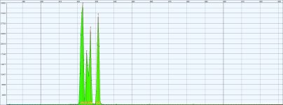

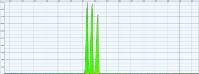

But they were hiding a very pleasant WL surprise: 524nm, 528nm and 533nm! In order!!
When driven low, there is a fourth WL!! I re-measured a number of times and consistently got 4 peaks…
To make things even more interesting, they all have very distinct thresholds with ~100ma difference between them, also in order!!
