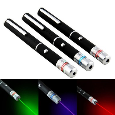

I purchased three sets of RGB (blue really 405 nm violet) pointers and measured the following output powers:
650 nm Red: 6, 8, 9 mw
532 nm Green, 14, 40, 74 mw (74 mw green was about 20 mw of infrared, so really about 54 mw of green. These DPSS pointers were not very stable, the power varied up and down 25% of these values, to the full peak power shown here).
405 nm violet, 25, 49, 52 mw.
Measured using a Coherent LPM (smaller thermopile in photo) and a Thorlabs power meter for the lower power pointers.
Another set of these cheap laser pointer pens arrived and were measured as following:
650 nm Red: 8.5, 11, 11.5 mw
532 nm Green: 17, 25, 32 mw (these DPSS pointers were not very stable, the power varied up and down from 2/3 of these values, to the full peak power shown here).
405 nm violet: 32, 50, 54 mw
Huh?? Still on the weaker side compared to pens sold years ago and surprised they are all close in power and no powerful odd ball that sticks out..
Have you taken any apart to see if there is a pot on the driver? I doubt it though as no pen iv'e gotten since I started this forum has one.
Only some oldies from Pman that he made focusable had a pot and not the green ones where he swapped in a Fasttech module.
The last batch had one at close to 75 mw, but 20 mw of that number was infrared, so did not contribute to the visible beam. This order did not have a higher power DPSS 532 nm pointer, all ho-hum amounts of green power to me, but the red and violet pens were about the same. I have not tried to open them to see if there is a pot or not. Regardless, these are very cheap pointers and for this price, nice.

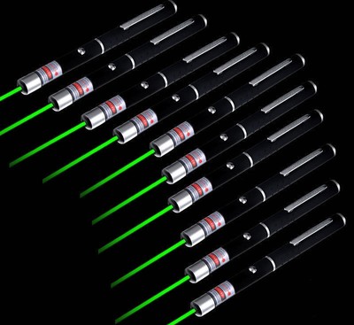

Ten 532 nm AAA pointer pens:
Measured powers: 54, 50, 70, 6, 50, 40, 43, 23, 46, 34. Fairly stable power outputs except for two of them. About 15-18 percent of the power output was invisible infrared instead of green.
That 6mw one is a keeper. Seriously!!
I'm curious if these are the style of pens that have the long black plastic lens and the module has the aluminum sleeve thats pressed into the host?
Yup, thats the style I was asking about.. ;)
I always thought they were the weaker modules but RedC had that same type in a few Military hosts that did well into the 100mw's.
Can you get a measurment of the base screw of that black plastic lens? I want to know if it's any where near the standard 9mm lens barrels we have now. Curious to see if there's a way to use it on a 488 diode to tame the box reflection??
