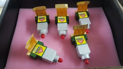

OK, confirmed now, the ebay seller is still misrepresenting the power of these NECSEL devices as 10 watts output.
Is this realy 10W check out the label unless its a fake label :unsure: s-l1600.jpg
That device is horribly inefficient at 3.8 percent, if it really produced ten watts output it would require near 300 watts of power input.
Click thumbnail to see the specs for that NECSEL.
A lot of laser manufacturers put labels on their equipment like that, they too often have a one label fits many, such as put a max power 10 watt label on anything under 10 watts, a max power 20 watt label for more than 10, but under 20 watts etc. I see this quite frequently on ebay offerings and the sellers will parrot the sticker on their listing as a specification when far from accurate. Like the stickers which for example say something like 800-1000 nm, they will then often list the unit as a 800 to 1000 nm laser when it is really some specific wavelength within that range.
Take this listing for an example, the seller is clueless these are not 900-1000 nm lasers, but that is what the label on the side says when it is actually 976 nm, but is indeed a 20 watt module, that is the problem, some manufacturers list the real power rating on the device, others way off from reality.
