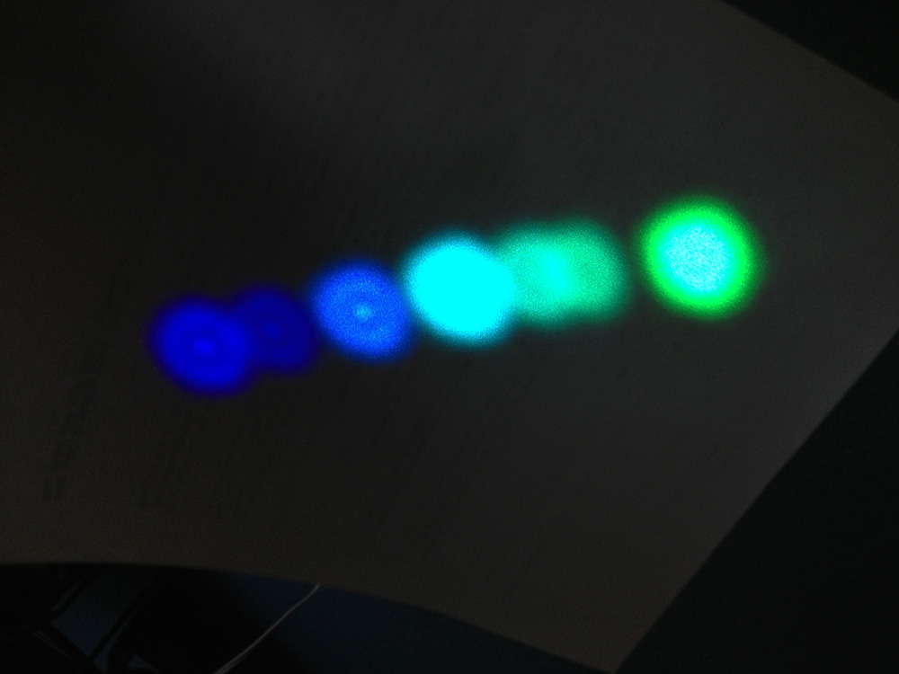

So I got all my optics and tools in, and I've been playing with external cavities all day.
I was using a 1% pass at 491nm optic on my 488nm single line.
Got this ;)
More to come with more experiments.

There has been some work done with that. Someone here got I think 9 lines from there multiline. Just have to have the right optics.
i may have access to the right optics. i'll give it a try tomorrow, if i do.
until then:
Such large dots :p
I will probably have to get an ML eventually. I know there are some tests that I need to run on one. Just needs to be a decent quality, self respecting tube.
Just recently got a book case to invest on some vertical space, so I can no longer complain about space.
EDIT: 8 lines from a 6 line. Used a pass blue, reflect green. Used it to get the two green lines. Although you're just missing one of the 470's. Can't tell from that pic... You have everything else in the normal spectrum from 457-514, so I'm not sure what else you could get. Perhaps 454. Or if you're super lucky, and your tube was specially made, 528nm.
