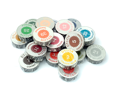

This is quite good method to "soft" anodizing aluminium. If you need "Hard" anodizing for your parts I suggest to find some professional to do that.
-Harder aluminum alloys may require more Amp's.
-Some dye colors work better than other's.
Some of Dylon Dye's that are known to be good: Ebony Black, Fluorescent Yellow and Forest Green
Always use proper protective gear, goggles, gloves etc
and NEVER ANODIZE ALUMINIUM INDOORS!
PS.
Boil your colored parts at least 1 hour
