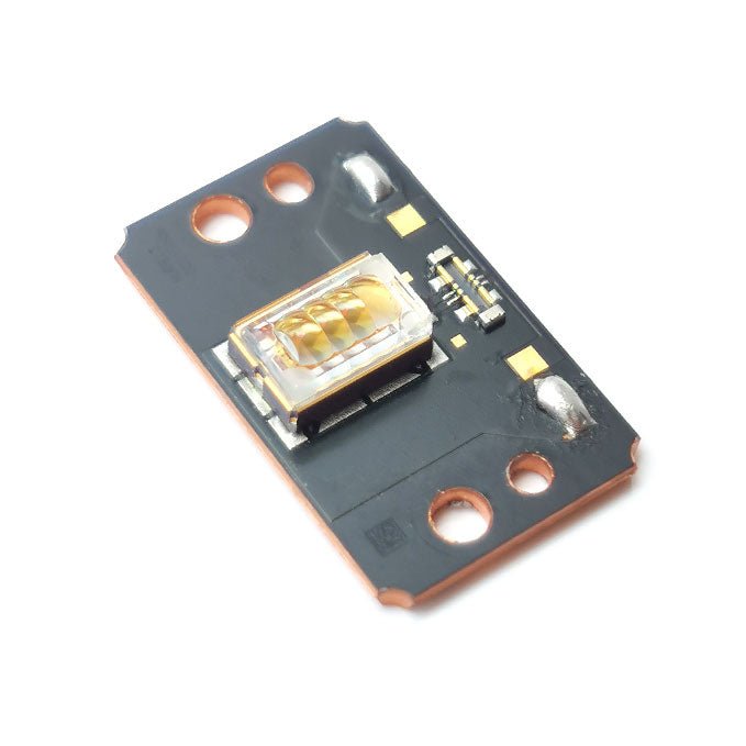

Hey Boris, I ordered one of these nubb13t to try out, the initial spacing between each beam center is 1.25mm where the nubm35 is 2.4mm and the nubm31 is 3.5mm, I will make a post when I get it and post a pic of what the alignment looks like.
If somehow the alignment is reasonably good, then knife edging a few could be fun.
What type of power rating would a tec have to be to keep the 13t running at 4 amps in a temperature range of 25-30c?
That is a neat little array 🥰

So after some reading, I've come up with the following for those interested.
First we calculate the electrical power input to the laser diode array:
Pinput=V×IP= V \times IPinput=V×IPinput=16.5 V×3.5 A=57.75 WP= 16.5 \\times 3.5 = 57.75 Pinput=16.5 V×3.5 A=57.75 W
This is the electrical power consumed by the laser diode array. The output power of 22 Watts is the optical power emitted as light, and the rest (57.75 W - 22 W = 35.75 W) is dissipated as heat.
Now to be safe, double up that value and a 50-70W tec should do the trick.
