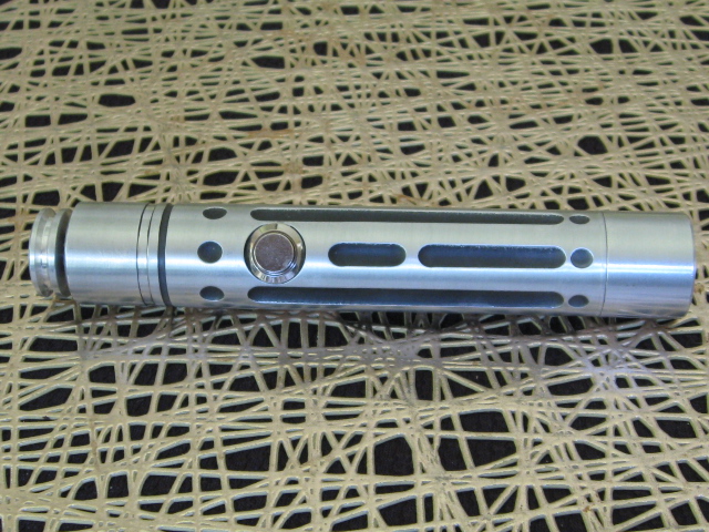

Here is another build that I made this year using a 488nm Sharp GH04850B2G.

Congratulations on your build. I measured many of these diodes and binned them by wavelength when they first became available here. They tend to run anywhere from 486nm to 493nm. The lower the wavelength the less green it will look. I have one doing exactly 488nm. I built one for my daughter that was 486nm. She loves that light blue color.
Great beam shots Murph, I also enjoy my 488's, I like the G8 lens the best and I usually drive mine @ 250ma
Love it, the wavelength is awesome. Nice looking host and great photo's, thank your for sharing them. I bought a few of those diodes to see what I might do combining the output somehow, I guess the only thing I can do is PBS combine, Knife Edge, or closely space several diodes to make the output appear as close together as I can.
This one must be on the higher side of the of those wavelengths, it definitely has a green tint to it. The GoPro just has a hard time picking it up.
It's also because the current is very high. If you run those diodes at above around 180mA they start to shift to green.
Happen to have one at around 486ish that I could buy off you? Really want to cover the gap from my 481-492.
Actually, these tend to shift wavelength with heat more than current.
Sorry, I have none left. The one I used for my daughter's build was the last one I had.
I have several of the 488's and one is noticeably more blue than all the others, I call it my imitation argon.....yes I know argons are gas multi line lasers it's just what I like to call it, I suggest buying several and see what you get as they are all very cool beams of aquamarine - teal and the one is almost sky blue.
