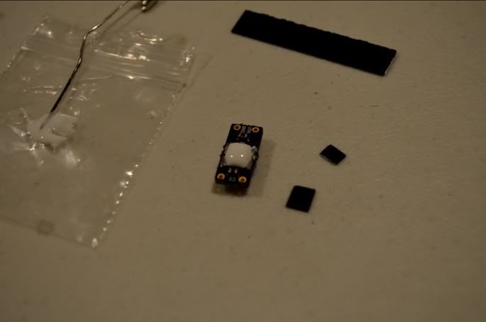

Heatsinking a 1.8A driver is absolutely necessary unless you want short runtimes
or to burn out the driver. I plan on sinking this driver to the back of the larger
heatsink that holds the aixiz module. To do this, I'm cutting small pieces from a
strip of black aluminum that came from a computer graphics card heatsink I took
apart. I have a dozen of these aluminum strips & they work outstanding to use for
heatsinking hot drivers
I'm using a generous amount of thermal compound so the heatsink doesn't short
any components on the driver
30 minutes to completely dry
The heatsink is sitting on enough compound to prevent the driver from shorting out
