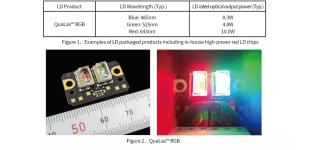

As we know them by nubb arrays now we officially have their name is QuaLas. As I had mentioned in past we would be seeing these used in newer projectors now is confirmed we have some information on the QuaLas arrays small form factor for projection and automotive laser needs.
Now I present to you the QuaLas RGB.The wavelength and output power are the following wavelength 465 nm, 525 nm, 643 nm, Output Power 8.3 W (Blue), 4.8 W (Green), 10 W (Red). To add more info like you'll see below 1 blue LD(4.15W * 2), 3 green LD(1.6W * 3), and 4 red LD(2.5W * 4).
These newer arrays come in 4, 5, 8, 9, 10 packages single and double stacks.
Why these new arrays? well they are just better for projectors and their design applications. Laser design offers advantages such as 10-15% higher efficiency, 40% reduction in size, 10% better heat dissipation, and approximately 30% lower cost compared to the more commonly used 14-chip and 28-chip lasers arrays.

I have updated the thread with more information as I was incorrect on number of Blue LD and total LD in package. numb12 model has arrise and is currently available for purchase. This model has an odd number of 9 LD total which matches the .gif animation on beginning of thread1000031948.jpg1000031947.jpg
This was looking pretty interesting until I got down to the divergence of the red :-(
Looks like not as good optics on that case I do believe these are first generation reds from Nichia so that could be it too i mean 2.5W per LD I'd expect them to be dual beam but looks like single beams so thats in the correct path at least.
I'm guessing it's the diodes themselves. All of the high power MM reds we've seen have had atrocious divergence.
