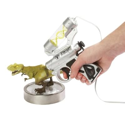

So I got this Xtractaurs toy today for the sole fact of making a badass grill ignitor/bug zapper. After seeing dieselmarine's http://laserpointerforums.com/f38/im-back-my-awesome-new-10x-lazergunn-51443.html I had to make one. The diode is from the AMK SF-AW210's group buy.
Gun $9
laser $10
Components $6
For $25 it was not to bad.
Already had a switch which made this build so easy.:)
There are actually green led's in this part but I got lazy and didn't hook them up.

Nice build! I like see these "toy guns" turned into lasers. I had to do a search for that thing since I wondered what it was for. This is what I came across. I don't think I'd be happy with something poking me in the rear either.
