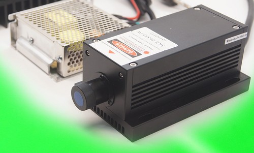

Edit: Here it is, 1400 mw: https://www.optotronics.com/proddetail.php?prod=Opto1400-Portable

I just found that a moment before you posted, but it's not a pointer. My bad, Paul didn't write pointer, but I thought pointer.
You also build by buying such a module, removing them and using a driver, I'm not sure because I haven't seen it yet, but you can contact seler
it is more expensive 100-150$
