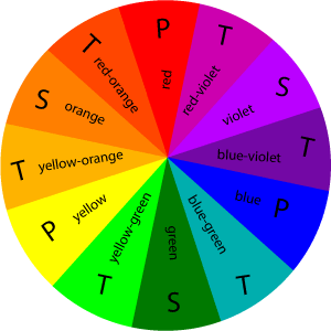

Also, if you look at the color wheel...
Green is the complimentary color (opposite) to red, so, it should provide the best protection against Red.
I would go for the Green ones. Shit, you could even go for the $10 green ones on Amazon, but they suck, and probably don't provide the level of protection that the Dragon Lasers ones do, and why try to save a few dollars if it is your ability to see that is at stake? Saving $20 is really not worth losing your eyesight for. :tinfoil:
