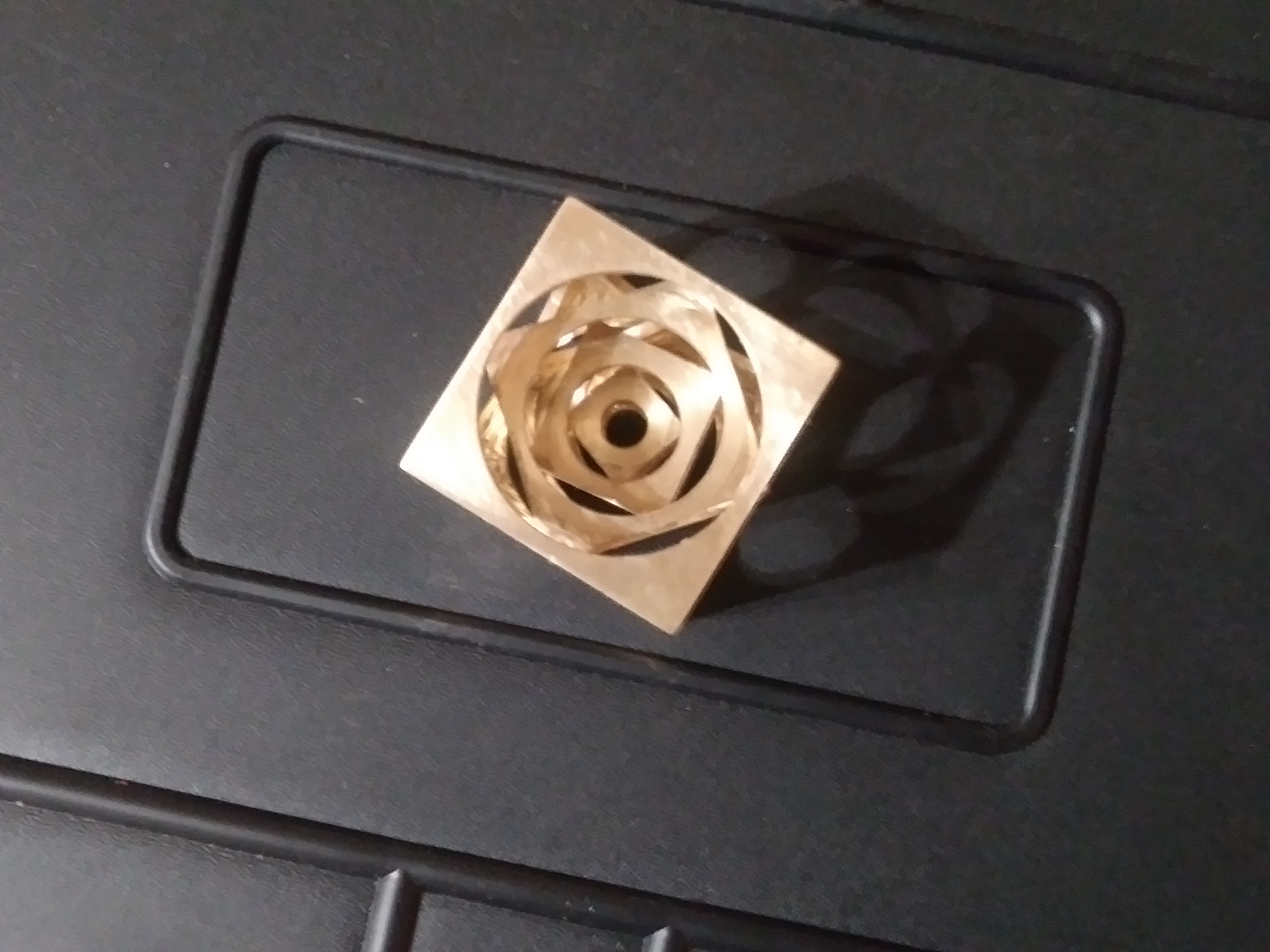

Now, that was impressive, Gadget. I don't have an idea how you accomplished this, unlike the cube made on the lathe.

Hi G,
Awesome work came out great , what is it for? Looks like a piece of art . Put it on auction starting bid 300.00..

That's something you see done on a 5 axis mill .......................have you ever cut your lawn with scissors ?
How the heck would you do that on a lathe, why would you do that on a lathe ?
Are you shaking my monkey tree here ? DING DING DING Movie reference..............( Name the movie........hint = Bill Murray )

Nah, guys...I'm not shakin' anyone's monkey tree (Caddyshack?). I really did make that purely on the lathe.
As for why...well...ummm...because I have a lathe? And, cylinders get boring? Also, I do not, I repeat...I DO NOT use any kind of hot glue or wax, I consider that cheating. I break 5 sides of the cubes free, then on the last side I cut in until there's just a tiny bit of material holding everything together. From then on, no motor. I remove the last bit of material by turning the chuck by hand as the cubes fall free.
(In my best JFK voice) We do these things, not because they are easy, but because they are haaaaaaahd.
