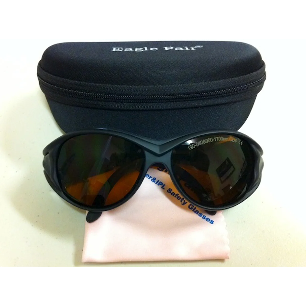

I have some Eagle goggles and they are like 190-540nm OD6+ so not too worried about any purple blue or green. The only thing is most of those 532 nm greenies have the IR leakage and you never know how strong it is pen to pen. I don't want to take any chances so I ordered some IR blocking filters to install in the lens cap. I'm hoping that eliminates most of the 808. I don't think it's going to catch anything 1000nm or higher ... still researching it.

Survival Lasers Eagle Pairs are the lowest cost actually effective and certified laser good glasses/goggles.
Cheaper are a crap shoot as to whether they work effectively at all.
