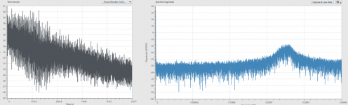

For curiosities sake I later zoomed in on the noise and it looked periodic, this is another section where it showed clearer, I did an FFT but without decent time base units all it showed was that there was some central band about which it was oscillating. I will post that and rest of story in a follow up since this is max number of attachments (if that is bad form here - let me know and will avoid in future).unstable periodic zoom.jpg

Continued from last post to allow attachment of additional data. The FFT of the section above is below (total real time in that capture window is probably around half a second - though time units here aren't known as the data was streaming) and shows that there was indeed some periodicity to it.
For comparison, I ran an FFT on an earlier capture at max output levels, captured before I first noticed what looked like odd behavior to me and it didn't show this broad spike:FFT of max output no oscillations.png
