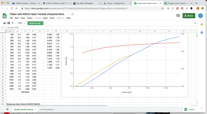

That data comes in handy buddy
We don’t need to run them to hard to get over 1W +
Rich:)C3805A68-9529-4B34-AFE1-1A2FA51BC9EF.jpeg1CEECB1E-6B58-466A-8CDE-6EE3DE27E087.jpeg
