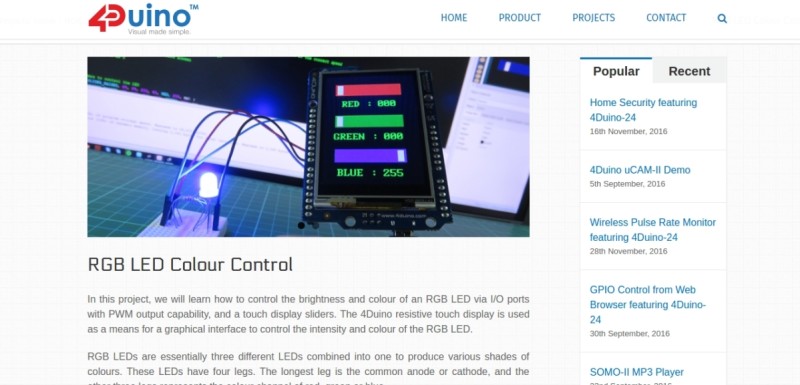

Also, with 4duino >> it would be actually quite easy add digital PWM controls for RGB laser.
