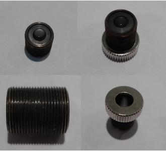

How do you manage to disassemble the laser. Is it necessary to heat, which part is unscrewed? :thinking:
And after how to change the acrylic lens? :thanks:
The barrel twists apart from the base (where the fins end). It is not necessary to heat any parts to make them come loose. There ARE two little spots of epoxy though. One is one the lens (from the outside of the laser) and the other on the inside on the Heatsink threads.
After unthreading the HS from the barrel you will be able to see the lens. It then just unsrews and you can screw anouther in its place ;)
If you are not confident about tearing your laser down to do this upgrade I would not attempt it. (Just don't want you to take it apart and not have a working laser afterwords ;) ) The acrylic lens is fine for a short amount of use just be aware that in the long run if it melts that you will also have to replace your diode as well.

i have the rifle 445 from lazerer to, and i'm about to replace the lens, but being the first time im buyng lens, im not sure if what i found will fit:
lens specs:
antireflection coated glass lens - visible spectrum
- Broadband - glass lens (coated)
- Laser module fits exactly with hosting,
12x30 bronze housing
- Anti reflective glass aspherical lens covered
visible spectrum
- Supports laser diodes 400-700nm range, up to 1W
- Broadcaster up to 97%
- Divergence in 1.2mrad
- Laser diode module casing 5.6mm
- laser diode type TO-18
