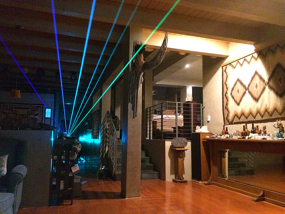

always a pleasure to fire up one of the argons in my house.
that was actually a double amici prism and not a diffraction grating. i really need to take a shot of my ArKr through it...
Hey Swami, would a roof prism from a binocular work? Oh, do you have a link to your videos? It's been awhile since I've seen one of those bad boys.
