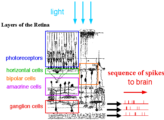

You are confusing laser propertites and characteristics with human visual system and perception properties.
No new or different wavelength is created buy combining wavelengths.
Colors created by combining wavelengths still remain the wavelengths used.
The words you used "purple" "magenta" and "white"are the words.
Wavelength is a physical property. Wavelength is not a description of a color you perceive/see.
Color is not a physical property; it is merely the brain’s interpretation of different wavelengths of light based on input signal from the eyes. Color names are words/symbols for that brain activity.
"Spectral power distributions exist in the physical world, but color exists only in the mind of the beholder. Our perception of color is not an objective measure of anything about the light that enters our eyes"
See this site : https://physics.info/color/
