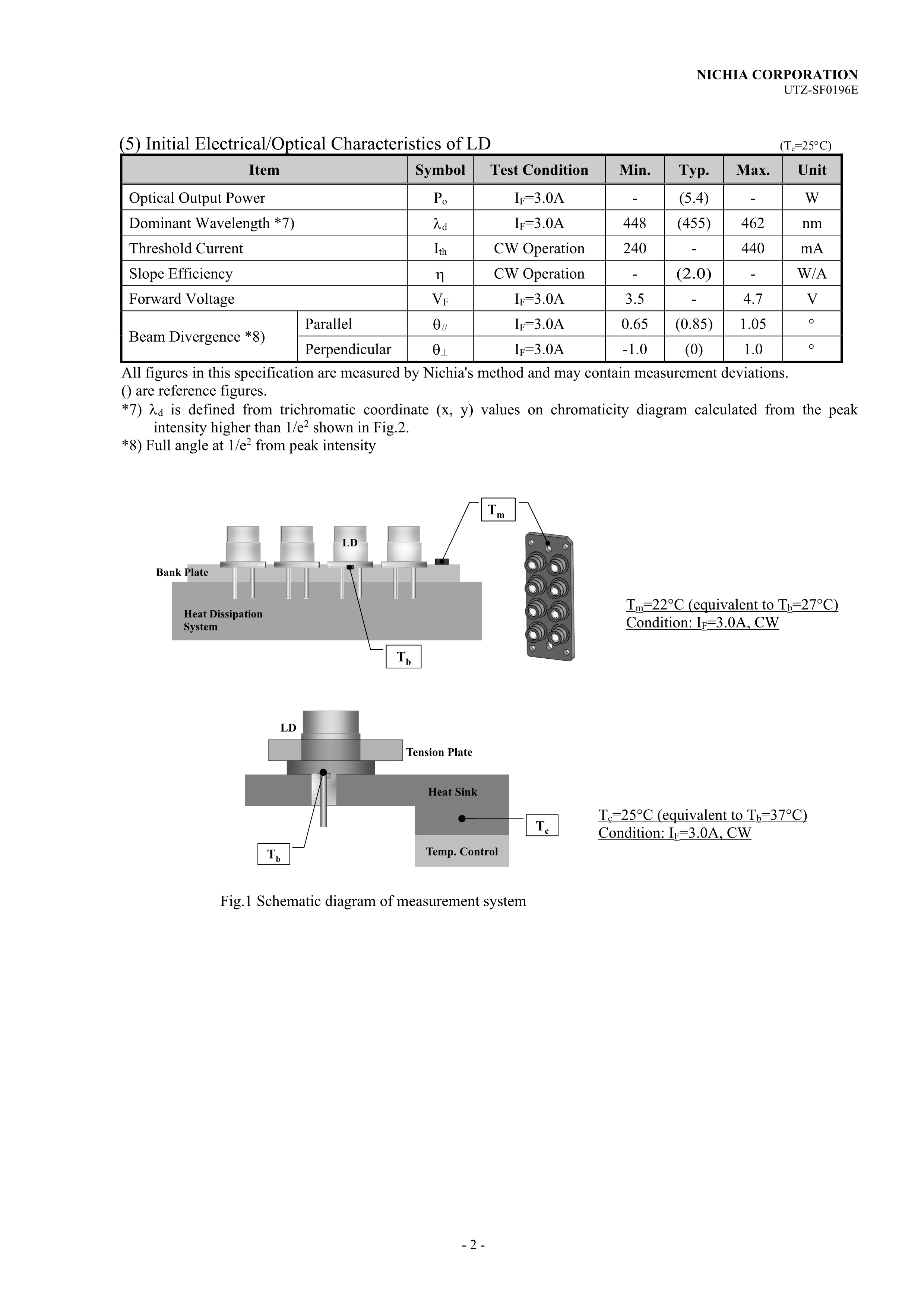

These are likely the strongest blue laser diodes yet, need to get lasertree to re-can some for us.
5.4W @ only 3.0A
Wonder what these can do pulsed. Was there not a 7-8W Num44 a while back? What I do like is the divergence. That looks great. What is a negative divergence Or even zero divergence. AnywY looks really good for graphics. Thanks for posting
Yea because they are GBall cans they measure the divergence with the GBall can intact, the raw divergence is very likely the same as a NUBM44 or any of the NUBM08/0A/0E when de-canned, but I always use c-lens correction on mine, also they would be good for home CNC with FAC enhancement.
I got one it seems to run cooler than a 7.5w diode that I have. Is more efficient when compared to NUBM44-V2. Divergance is huge but a G2 seems to focus it pretty well at close range. I got 8.08W with G2 lens at 5.1A / 4.91V input power was 25W. I don't have a professional LPM so take this numbers with a grain of salt. From visual inspection color shifted 460nm+ at around 4A
