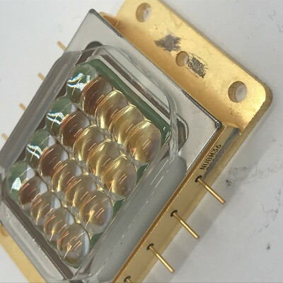

The T from what I understand just means Test sample which the modules with tin pins wouldn't be as they are no doubt pulled from equipment, I would like a virgin with clean pins but those can also be uninstalled stock........the only difference I could see is if the test samples had the best gang lens where as pulled modules could have gang lenses made to OEM specs ..........I saw this with the nubm05,06,07,08,42,49,OA as some GBalls were better focused than others.
The nubm31 might be had for less and likely would work just as well for our purposes, I am thinking about a big homemade BE right after the intact gang lens as long as it's collimated/focused as well as the one in Drakes video
I have all kinds of concave/expanding lenses some even AR coated and some pretty wide reasonably long FL output lenses to make a big BE

Looking at the pics the 31 and 34 look the same on the outside, may be the same with just a different rating different part number.
I see a number " 0 "on both gang lenses molded in to the glass and an oval imprint, both look the same from what I can see, I'm inclined to go with the less expensive unit but would prefer NEW although Techhood has the 31 listed as refurbished for 279.00 and Exostism has it listed as NEW for 300.00, both are the same exact tin pin pic.The 34 pics are different pics but look like the same build from what I can see.

RC, Styro purchased his array in 2019 when no 34T (24 beams) was still available, so he only could have bought 31T (with 20 beams) back then.
About GB feeler: I would wait until more models come to light, now a new model seem to appear on ebay every month, otherwise we could be in a situation of someone who bought nubm05 array for 600usd while 1 year after nubm08 was available for 300usd. Also, on ebay pictures I only see 34T tin-pin, so they cannot be new as seller pretend...and maybe I do not trust words such as refurbished?

Interesting the clean pin nubm31 has a pic showing 20 and the tin pin nubm31 shows a pic with 24
Also the nubm36 shows 20 while the nubm34 shows 24
It's possible the tin pin nubm31 is the wrong pic.

The device I purchased on ebay was listed as NUBM34T. The product label is NUBM34:
On eBay and AMAZON, pictures don't always match the product offered.
The had caused me some WTF moments now and again.
The pictures I posted on the 445nm forum 05/08 are of this device: NUBM34 which has 24 diodes, the gang collimator has 24 lenses.
Hold-down screw marks on the base plate suggest the device was installed, previously.
A few of the diodes deliver less output than the others. I suspect that it may have been removed from equipment for this reason.

I bought the Osram array and the beams are poorly focused via. the gang lens, next time I will get a N-brand array as they look to be better collimated. Here's mine with an additional lens.....it is usable for desktop burning but not so much cutting, not with just a simple lens, maybe a very short FL........but the far field didn't look as good as the nubm31 and there's a lot of overspray.
