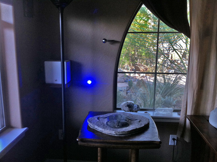

each 445 diode is individually prism corrected before they are combined via the pbs cube. the extra mm1's and mirrors are necessary to correct the horizontal and vertical deflection from the beams passing through the prisms.
yes, it's lossy, but those blue diodes have power to burn (pun intended) and the resulting beam has really excellent divergence (~.6mrad on x and y) and is symmetrical.
the goal was not to maximize power but to get the shape and size of the blue beams similar to that of the red and the green. this gives me much better far field image quality and alignment.
here's the spot at 40'.

That ain't bad for 40ft.. given that you do graphics I'd imagine that's quite a good arrangement. I'm almost never on the graphics wavelength as graphics shows comprise maybe 1% of the shows I do.. for beams I use the 450nm diodes straight up, with 3-element lenses, no correction. 2W+ of blue per diode with a divergence of .5 x 1.8mrad. For beams they work fabulously, the fast divergence equals my highest powered greens.
