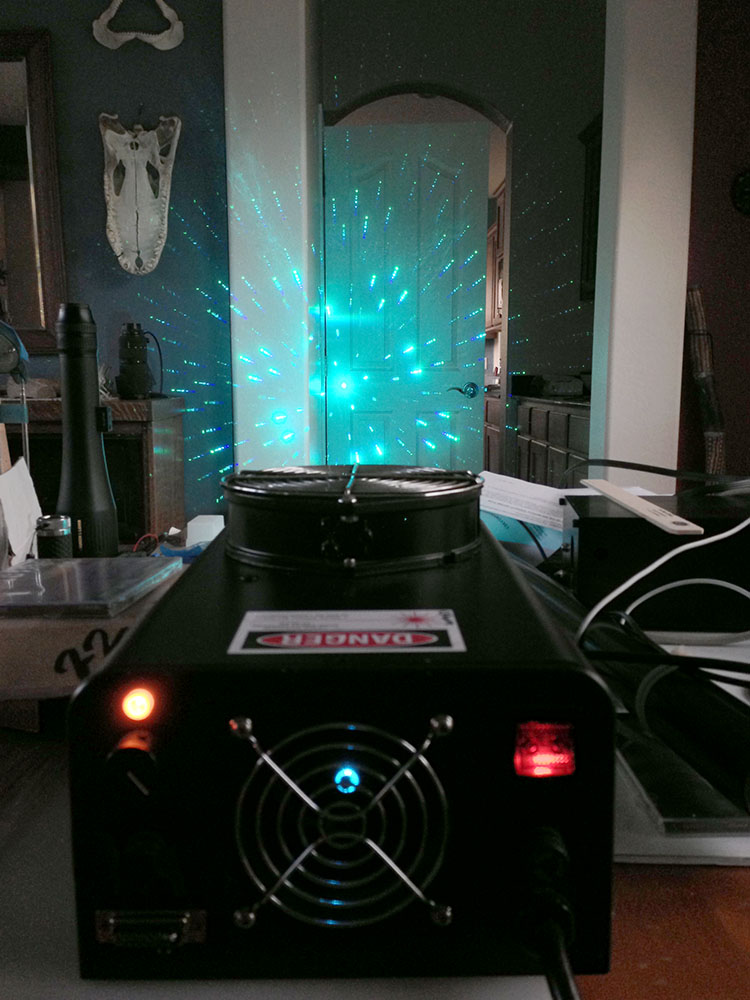

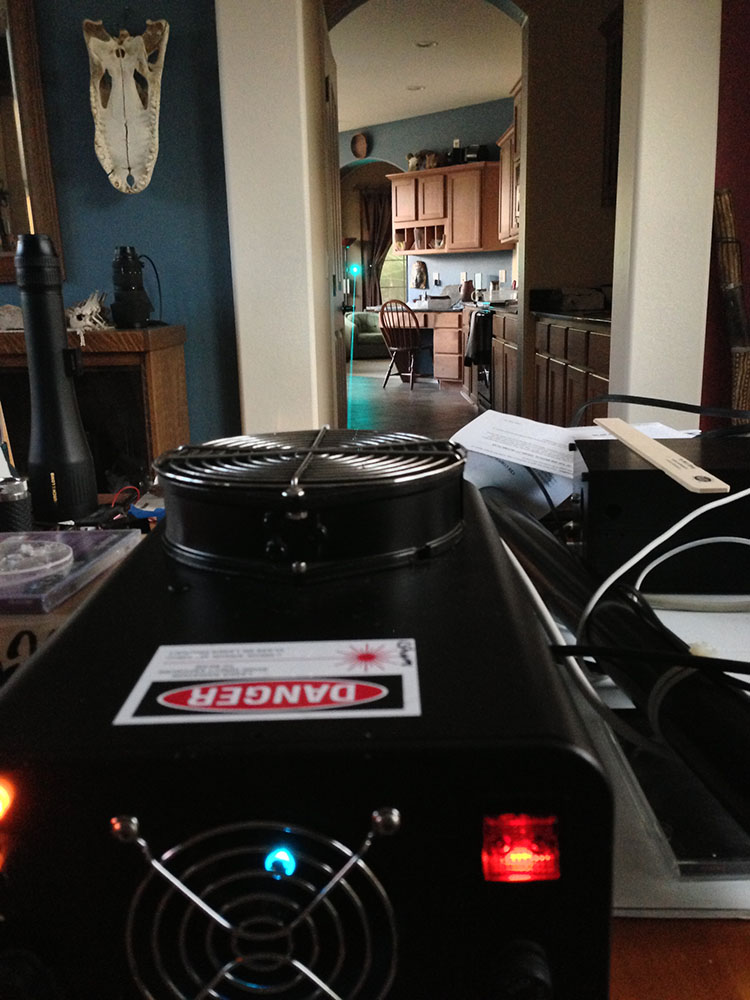

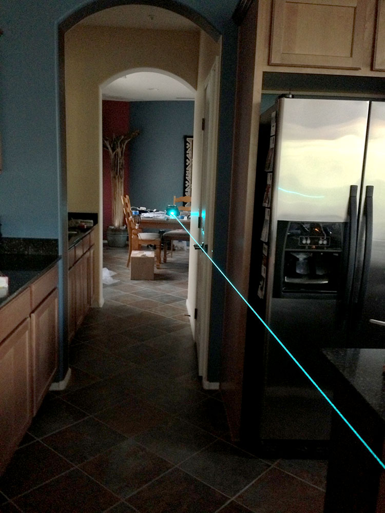

i'm the one with the 270mW 7 line air cooled argon (reliant).
i paid 150$ for it.
it is loud, tiny, and s-e-x-y. think of air cooled argon lasers as hair dryers that just happen to make pretty light.
