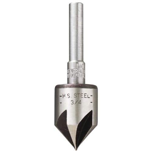

OK this is important.  To those that have not installed your diode into your pocket, follow these steps.  I've had a few people ruining thier barrel head by trying to press the diode into the pocket.
YOU HAVE TO BEVEL THE POCKET.
THEN ONCE YOU'VE BEVELED THE EDGE INSERT A DEAD DIODE!  This will shape the diode pocket to the diode without damaging the diode.  Remove dead diode and then insert the good one.

So that is why i have had probelms (i lost a $55 diode [smiley=sad.gif]. How would i go about doing this then?
Re: Laser Barrels V2. GB. Second run. Kryton Groov
use a razor blade to cut the edge down, or go to a local machine shop and ask to borrow a deburring tool.  the deburring tool will cut a bevel in seconds.
You could probably also use a countersink in a drill to cut a bevel.
using a drill bit, sized much larger than what fits the hole, will work too.
